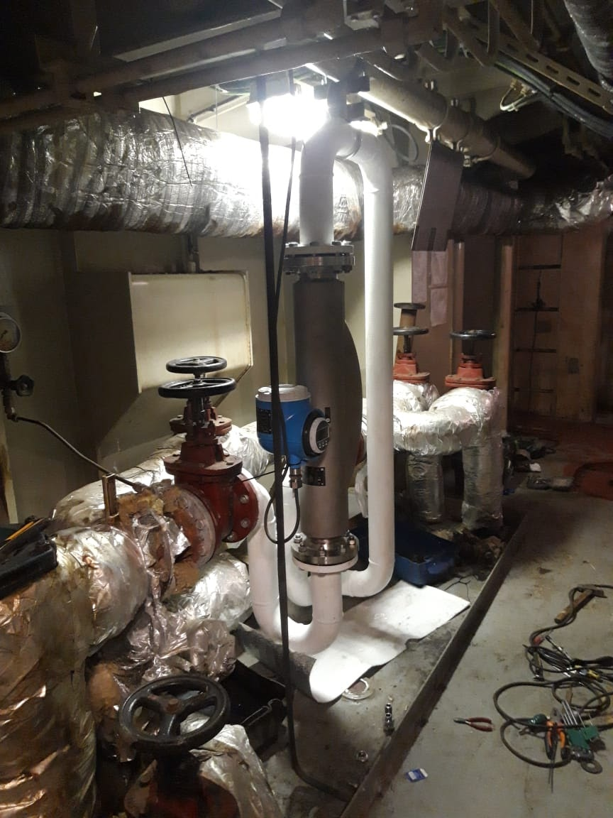

  • The integrator's specialists decided to replace an old fuel counter with a modern flow meter Endress Hauser series f300. The measurement error for this device is no more than 0.05%. It measures mazut temperature, density, and weight. The volume is calculated separately based on the weight data.
  • The flow meter displays all the parameters on-site. An additional panel OVEN SP307 was also placed at the captain's bridge upon the client’s request.

No welding on board is allowed. What to do?
According to safety regulations, welding was forbidden on board the ship. To meet the Maritime Register tough requirements, the hardware should have been installed in strictly limited space. The fuel line’s correct geometry should have been observed as it was critical for eliminating the chances of water hammer and bubble formation during the flow meter operation.
The integrator found a way out by making necessary calculations and welding pipes using templates in a workshop. Pressure molding and priming also took place in the workshop. There were several fit checks before the finished frame and all the devices were installed aboard SASCO ANIVA.
After detailed calculations, welding, pressure molding, and priming in the workshop and several on-site fit checks, the hardware is safely installed and ready to go.
