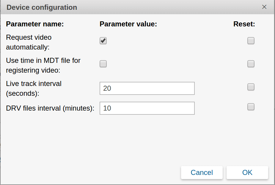

 Configuration tool is consistent and user-friendly. A user can set up tracking system server address, configure video quality parameters for primary and secondary cameras and their performance when an event occurs (speed limit violation, accelerometer response or alarm button activation).
Telematic data transmission function also claims attention: online mode presupposes less frequent message sending (once in 20 seconds, for instance). However DRV files are regularly sent to the server. The files comprise points collected every second. Online messages sending intervals and DRV files sending frequency are determined by the user in advanced unit properties in Wialon system.
Settings
After the data is automatically uploaded from the file, a track attains higher quality and becomes more detailed.

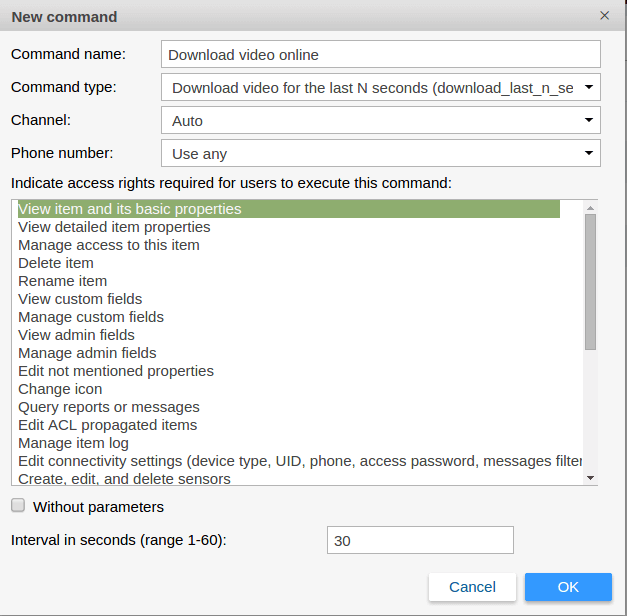

In case of harsh braking for instance you can assess driving style and find out the real reason of road traffic accident. Moreover in any moment Wialon operator can send a command to download a video footage over the last N-seconds.
Command En
 Depending on memory cards selected and video settings, a command from Wialon system allows to get a video file from archive (the lower quality and the higher storage capacity are, the earlier files are available for downloading).
