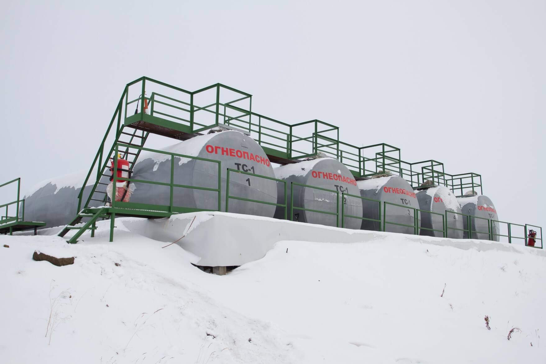

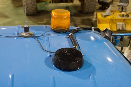

Naviset equips the machinery, refuellers, and fuel storage tanks with GPS trackers and Iridium antennas to make the equipment send data to Wialon in real time.
The solution: Fuel control “Starter pack”

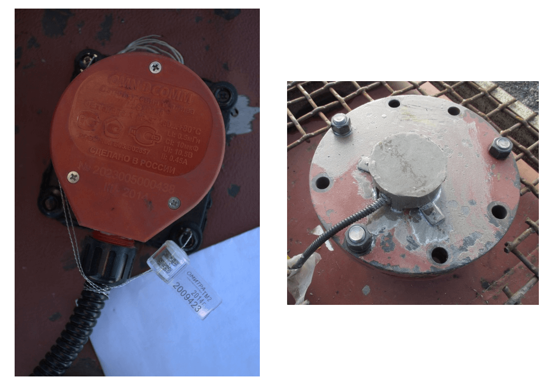

Then they install FLS on the huge fuel storage tanks and refueller reservoirs, seal the place of hardware installation and cover it with a metal lid. Thus, Naviset minimizes the risk of telematics equipment being damaged. Otherwise, physical intervention is at least visible for mechanics.

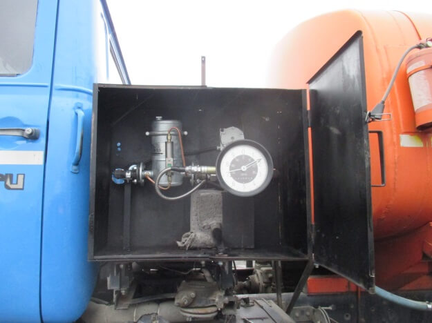

Drivers and refueller/petrol reservoir operators get authorization cards bound to a particular unit (machinery or fuel storage tanks). The huge reservoirs and refuellers are also equipped with RFID readers connected to GPS trackers. To fill the refueller both the operators should insert their ID cards to the readers. That’s how Wialon receives data on all parties involved in fuel filling, its interval, and the volume of “Fuel traffic”.
When filling the machinery, the driver inserts his card into the reader on the refueller, a green light comes on, and only after that, the operator starts a filling procedure.

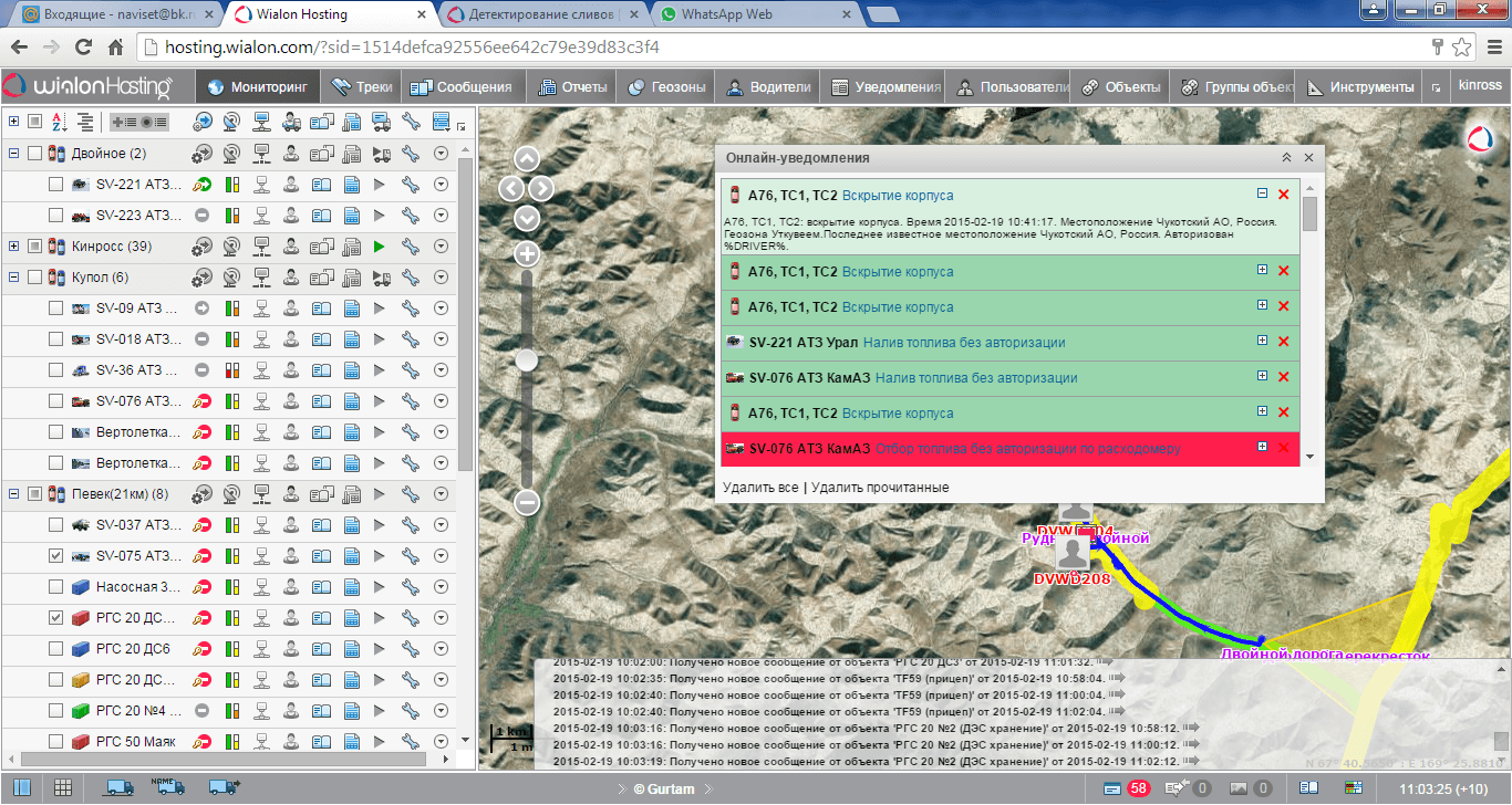

For each fuel storage tank, refueller, and machine a unit in Wialon is created. Plus, ID cards exist in the system as drivers. The card number is specified in “Driver properties”. The latter helps to identify the employee at the wheel.
Then we continue with the “Sensors” tab in “Unit Properties”. Depending on the unit type, the following sensors are created:
  • Fuel level sensor
  • Counter sensors for fuel flow meters
  • Driver binding sensor
The latter triggers when the driver inserts the ID card into the reader. By its number, the system identifies the units being filled or distributing fuel. Moreover, the sensor helps to detect the event interval (when the card was pulled out).
Put it simply, this is how the message in Wialon looks like:
“The Fuel storage tank #1 distributed fuel to the Refueller #1 (card 12345).”
If there are two units with RFID readers involved in the process, the messages from both of them look like this:
“Distributed to Refueller #1 (card 12345)/Received from Fuel storage tank #1 (card 54321).”
If a unit was not authorized, a refueller distributed more fuel than it fits into the tank, or too many fillings are detected, the system informs a dispatcher via pop-up notifications. He promptly responds to violations, registers notifications as custom events and leaves comments that can be later seen in reports.
The map is used for a quick overview of stationary fuel reservoirs, refuellers, machinery, fillings and thefts markers. It can be later attached to reports.
