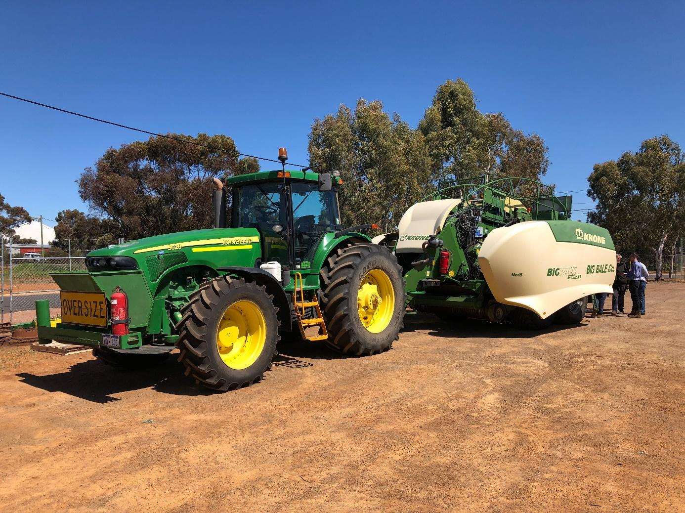

Big Bale Co is a leasing company offering special machinery for hay baling in Australia. It is used to press the hay and pack it into piles. The company is offering its services to farms that need to turn the grass into hay piles. Each farm usually rents equipment as the machinery is costly, around 350,000 AUD for the tractor and 250 000 AUD for the hay baler.
  • Hay balers are in the fields for 24 hours a day to finish the work before the end of the season. Considering such a tight schedule, it is essential to make sure that the utilization of machinery is done in the right way to prevent breakdowns.
  • The number of hay bales produced must be calculated because farmers pay not only for the time they rent machinery but also for the number of bales. Before solution implementation, the customer could not directly get the information about the number of bales produced, or it was sent with delays and was inaccurate.
  • No one from the management team could reach the location if there was an issue with reporting, as the equipment is often leased by farmers in remote areas.
  • Some conflicts arose with farmers who reported fewer bales produced.
  • It was impossible to track rebales. The pile would often fall apart and somebody would have to fix it manually. The so-called rebale wasn’t counted in this case.
1647510541419The company’s tractor with a hay baling machine

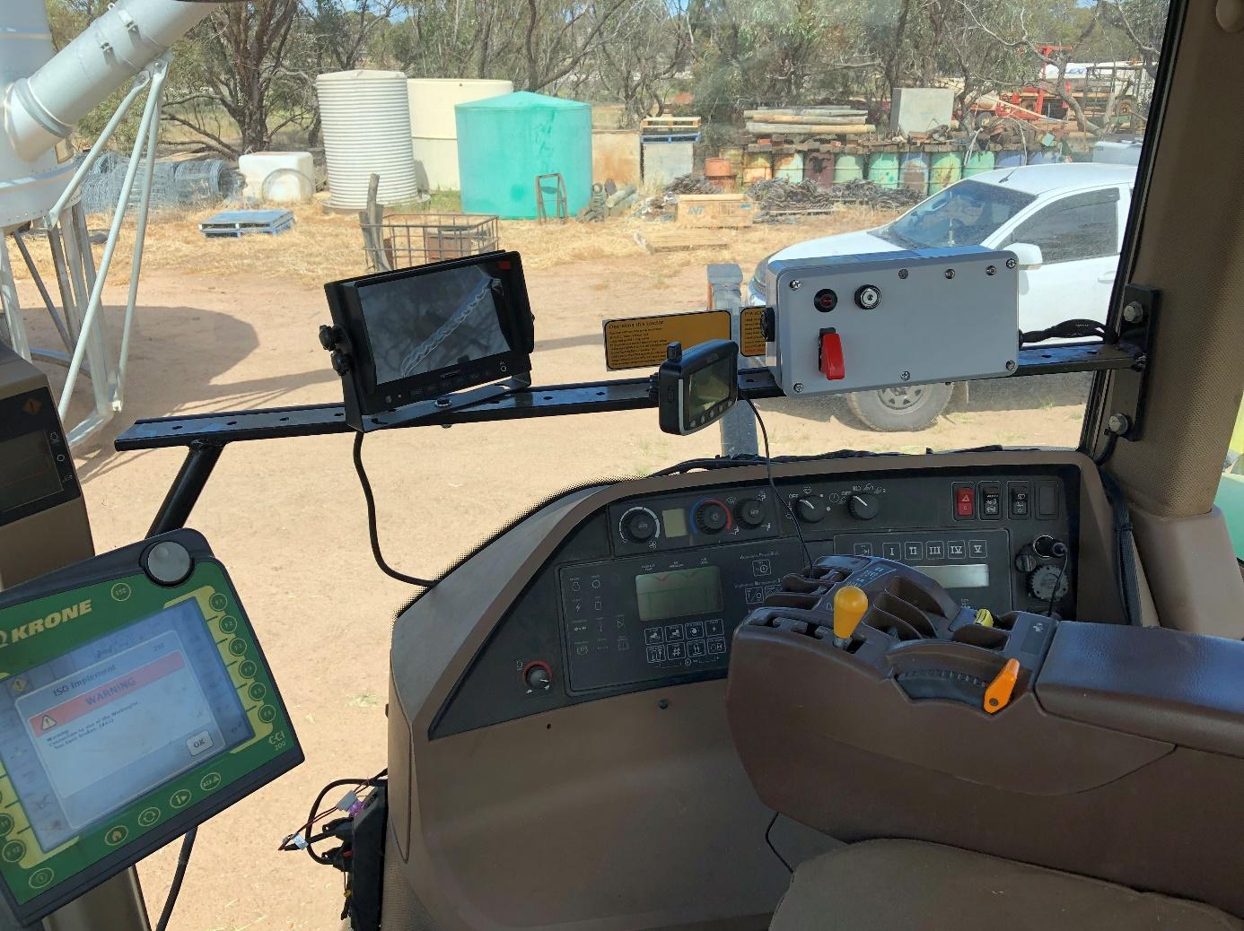

  • Digital Matter Dart trackers were installed on hay balers to track their location, speed, some other parameters, and the info from additional equipment.
  • A sensor was added to calculate the rotation of the arm inside the baler to count hays produced. 4 rotations mean that 1 bale has been made. The counter was connected to the tracker and sent info about the number of piles produced.
  • A standard Digital Matter iButton reader was used to identify drivers and connect them to work performed.
  • A buzzer was set up to notifiy drivers about the necessity to use identification tablets.
  • Waterproof boxes and proximity sensors completed the hardware part of the solution.
  • All the data was sent to Wialon, the GPS tracking platform. There, geofences were created to know how many bales can be produced for a particular area. With returning customers, it allowed to compare how many bales were made last year, plan and estimate future works. Notifications were used to see when the bale drops off.
  • A special button was installed to calculate rebales. As soon as the driver presses the button, the rebale is counted. It’s also recorded in Wialon via the notifications module.
    1647510995089
The white box with a tracking device, an iButton reader, and the button that a driver presses to record rebales
