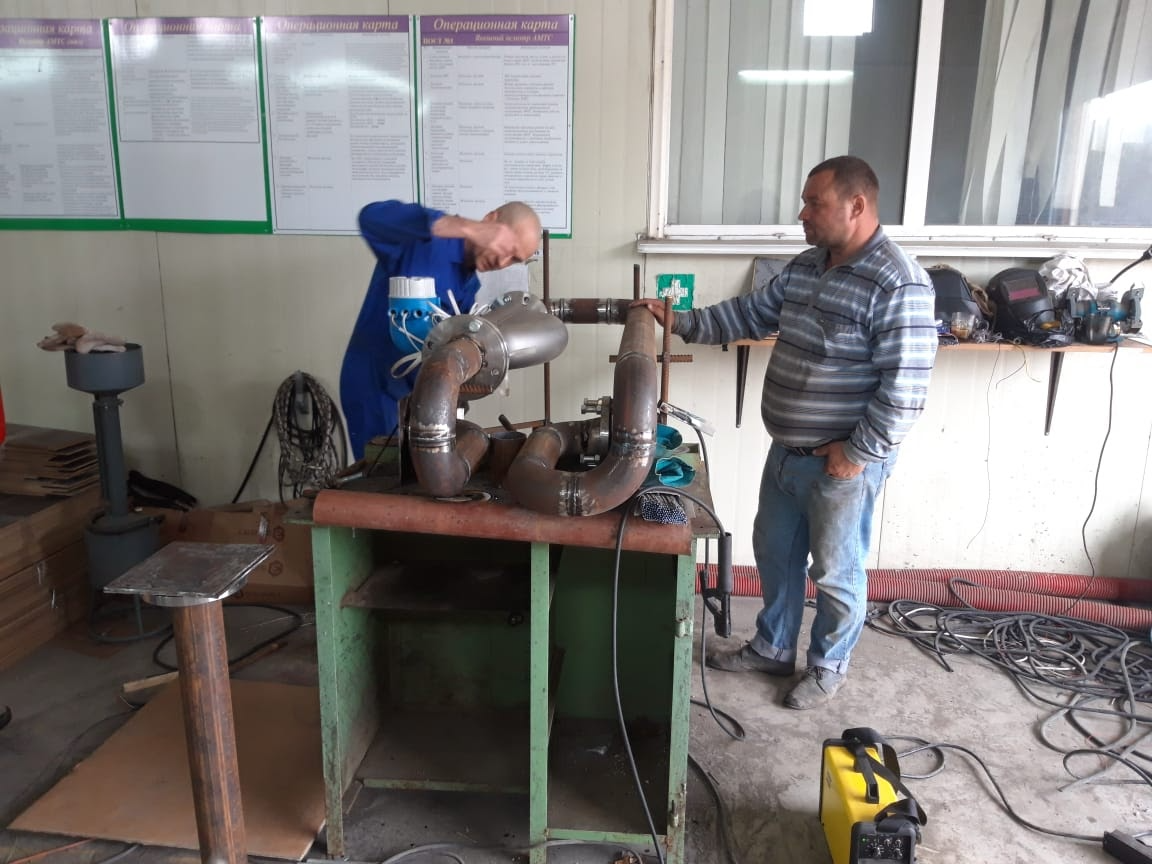

  • Safety regulations precluded welding on board. At the same time, the hardware should have been installed in a strictly limited space observing the fuel line’s correct geometry. The Wialon partner welded pipes in a workshop using templates. After several fit checks on the vessel, the hardware took its place.
Welding pipes by templates in the workshop
