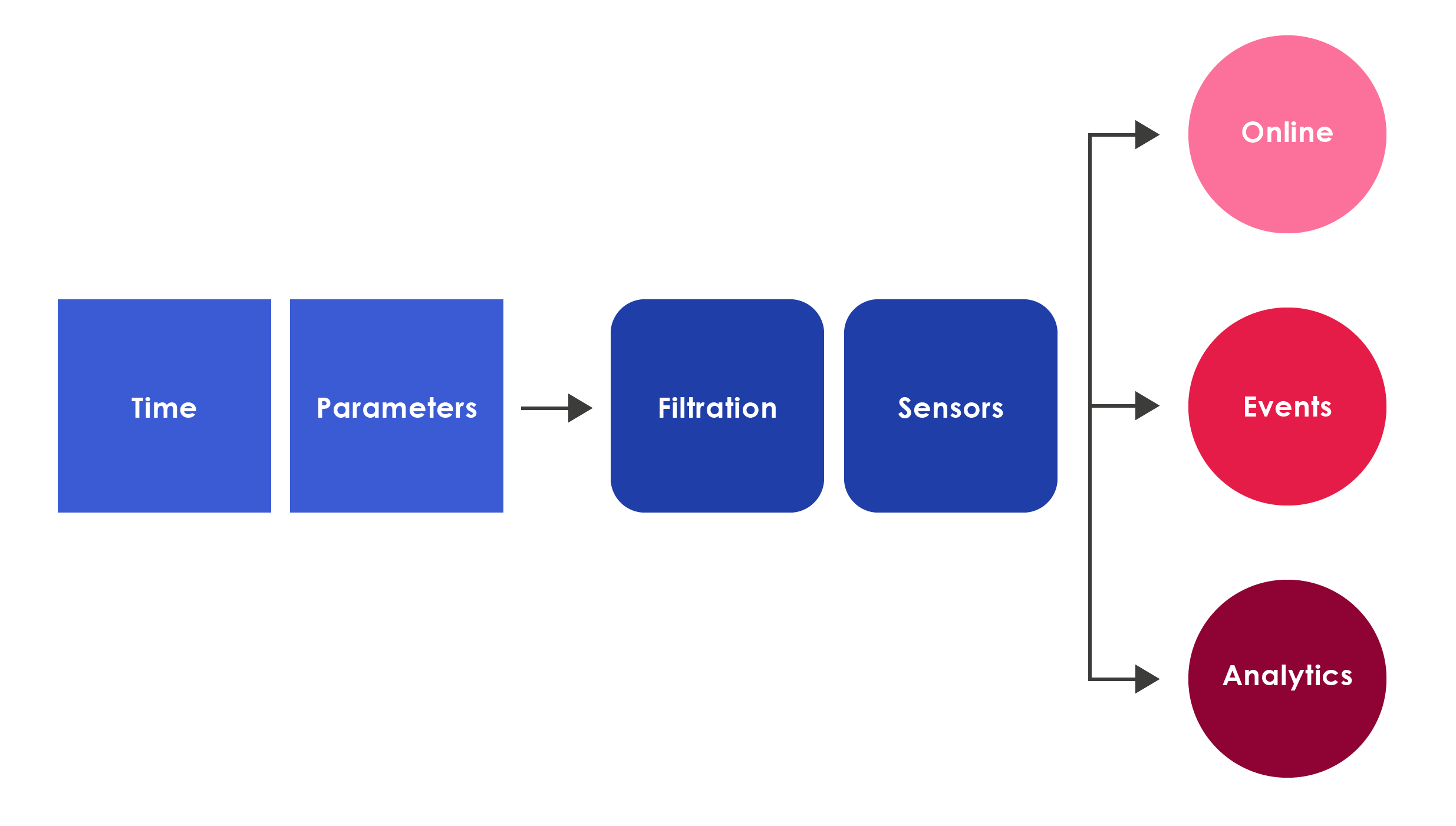

Steps New.pngSteps in Wialon's data processing
Let's talk in more detail about each step of data processing in Wialon.

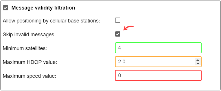

Message validity filtration
Wialon deletes the data that falls into the category of inaccurate according to the validity settings. All settings are made by the user, otherwise, Wialon will not delete anything.
Let's briefly recap how message validity filtration works:
  • Go to the Advanced tab in the unit properties.
  • Open the message validity filtration section.
  • Choose your filtering conditions. For example, filtering by speed (the most common criterion) or the minimum number of satellites.
  • For trackers which can determine the message validity themselves, select the Skip invalid messages option.
Message validity filtration setup

Three main types of data processing
Now when we know what we mean by data in Wialon and what are the bottlenecks with its preprocessing, let’s proceed to the final step, i.e. data processing.
There are three major data processing methods in Wialon that users turn to most often. Two of them – online and analytics – have been around for a while. The third method – events –  has appeared recently.
The methods work with the same messages.
