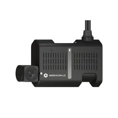

Seeworld V7 PRO
Number of units
0
Online
Total
Features Seeworld V7 PRO:
  • 4G/LTE
  • ADAS
  • DMS
Supported in Wialon:
  • Event video
  • Remote management via GPRS
  • Live stream
  • Manual video saving
  • Playback
  • Remote management via SMS
  • Communication via TCP
The following data should also be added to Seeworld V7 PRO unit properties section of Wialon GPS tracking software :
Device type: Seeworld V7 PRO
Unique ID: custom
Specify the following parameters in configuration software or configuration Seeworld V7 PRO for use in Wialon Hosting :
Server port: 23012
2 units of Seeworld V7 PRO device type are connected to Wialon Data Center. This represents 0% of all Video monitoring connected.
