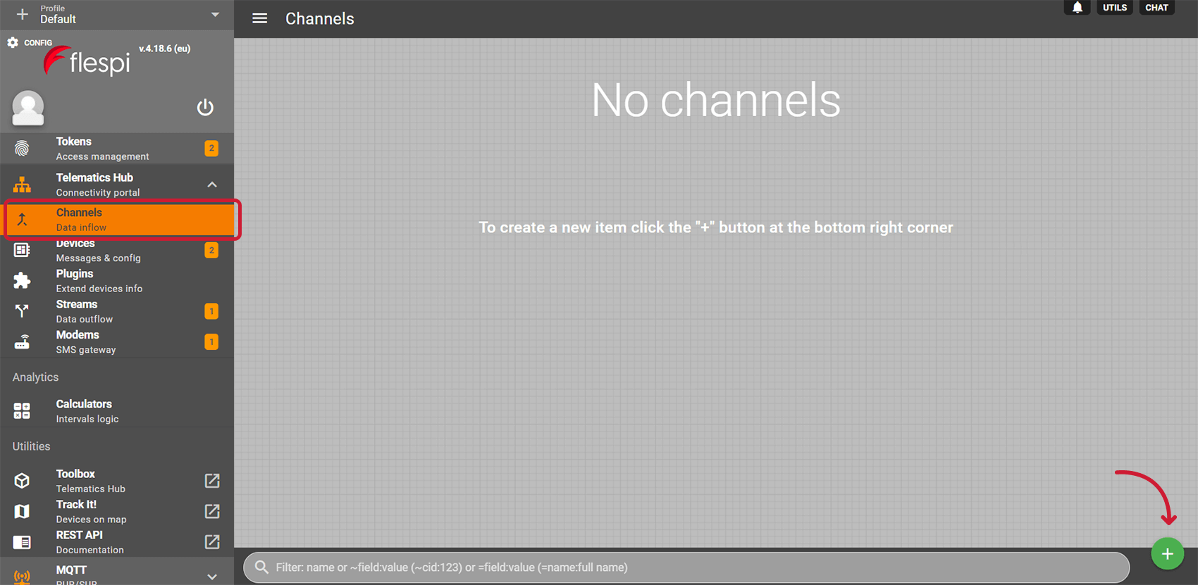

Setting up a flespi account
The next step is getting a flespi account on the flespi official website.

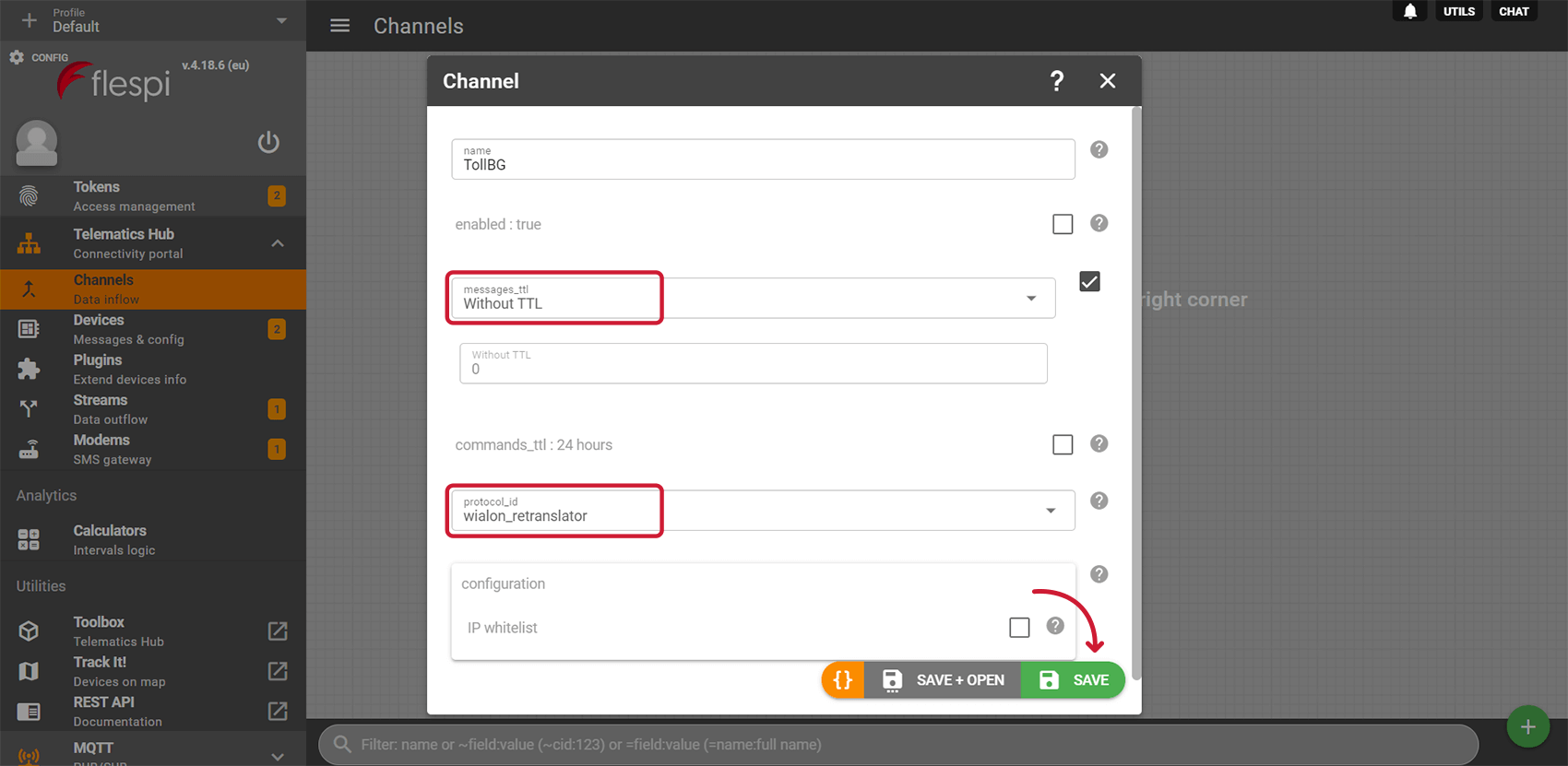

  • Create a flespi channel:
  • Choose wialon_retranslator as protocol_id:

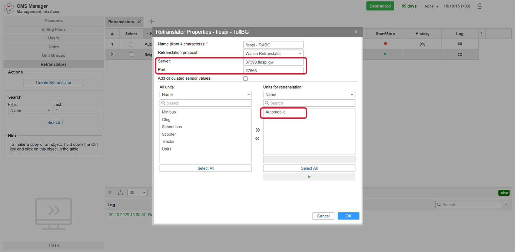

  • Point your Wialon units to the generated IP:PORT via Wialon Retranslator protocol. For this, configure a proper retranslator in Wialon and add multiple units if necessary:
NB:  Don’t change the original Unit ID.

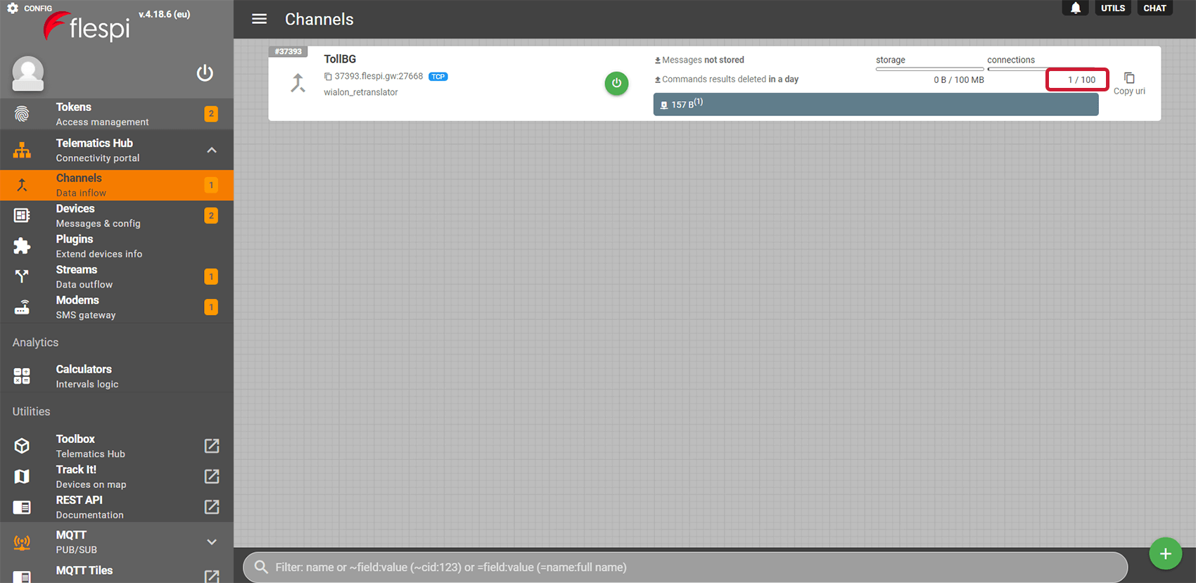

  • Click on the flespi channel and go to the Toolbox tab to make sure the data is coming to flespi (there must be at least one connection):

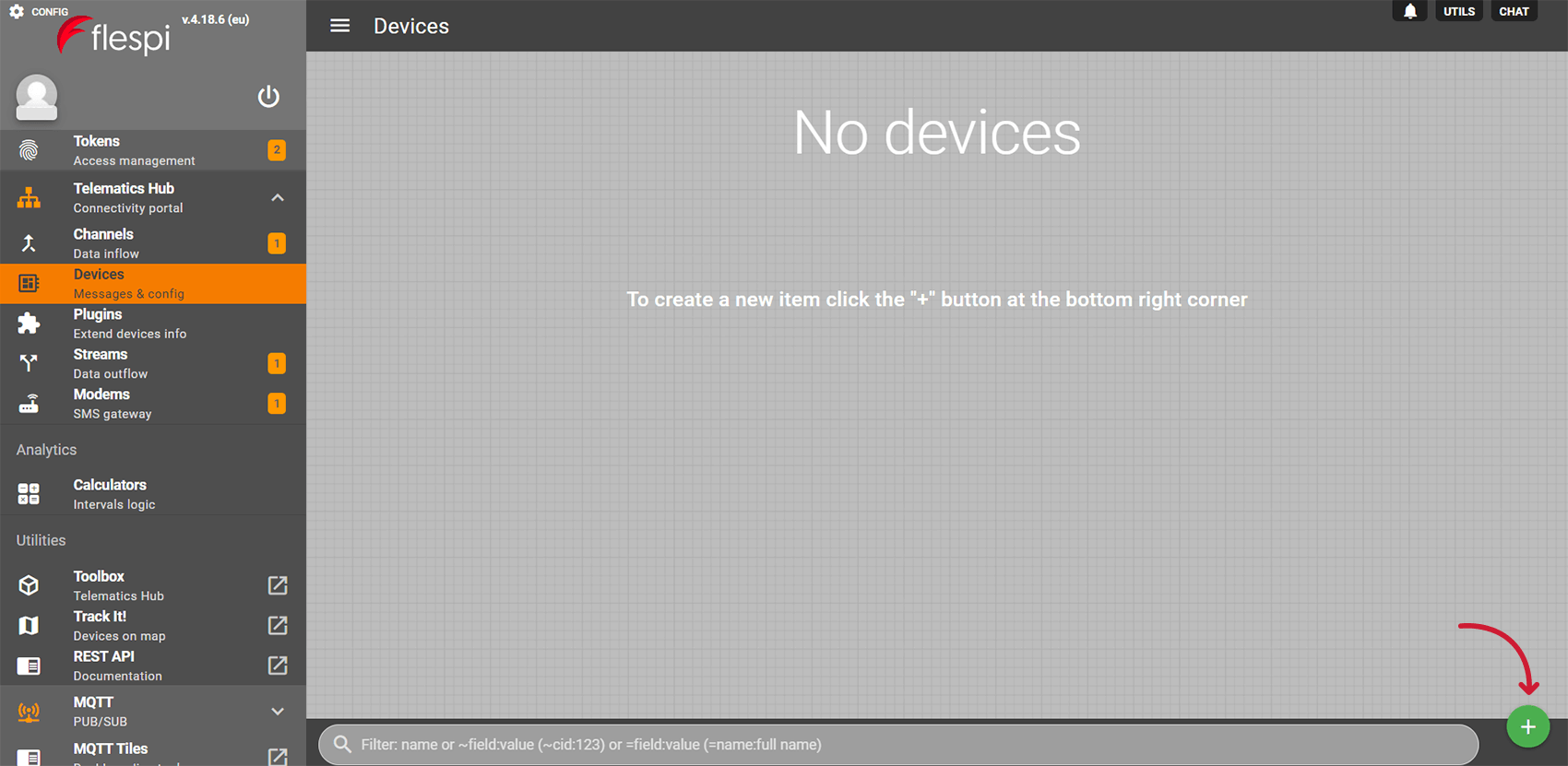

  • Create a flespi device:

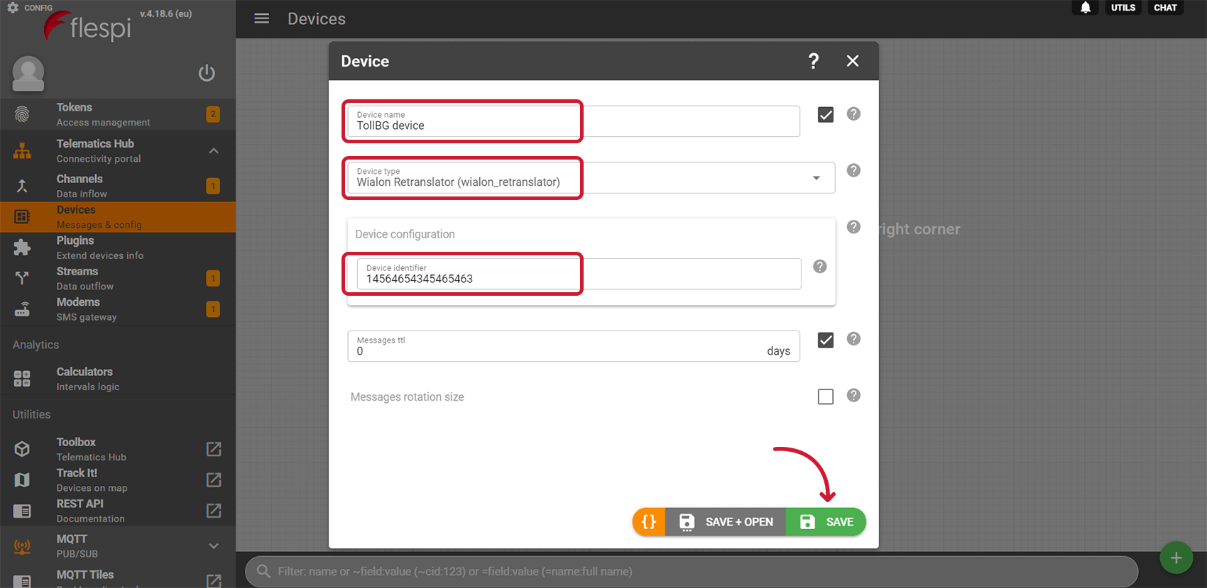

  • Enter the Device ID from Wialon into the Device Identifier field, choose the appropriate device type, and click Save:

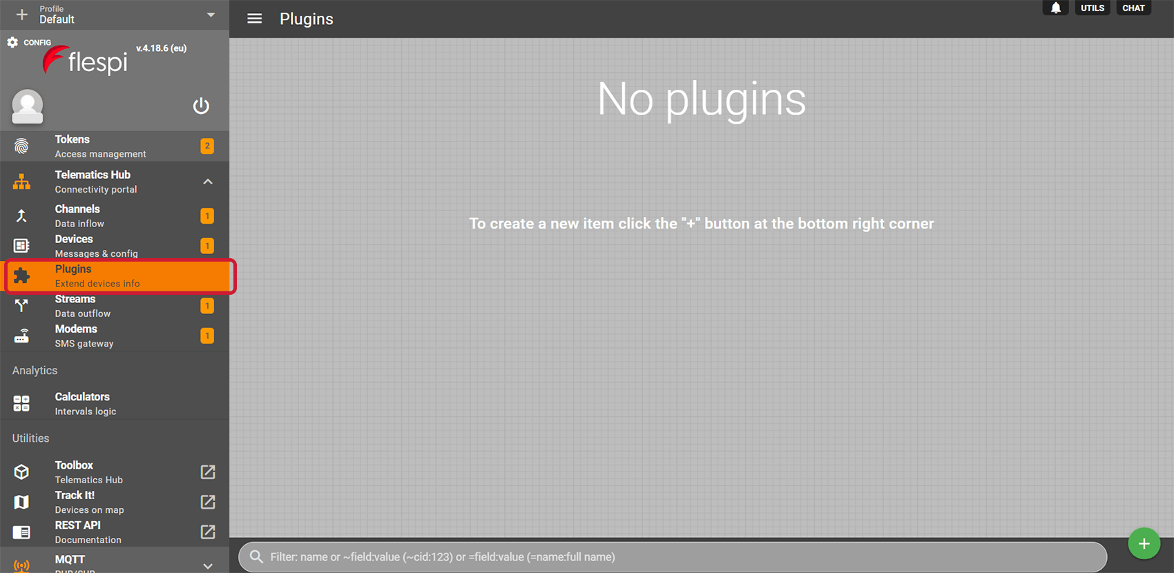

Then you need to create a plugin for your device.
  • Go to the Plugins tab and create a new plugin:
Create a new plugin

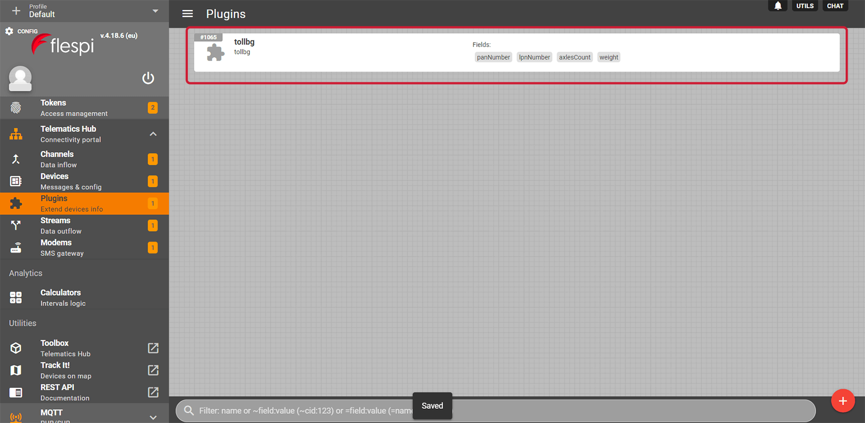

  • Choose the tollbg plugin template and click the Save button:
  • Here is the result you’ll see:
A new plugin created

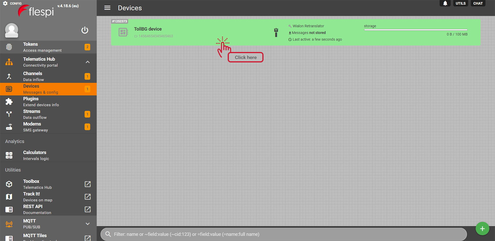

  • Open your device settings:

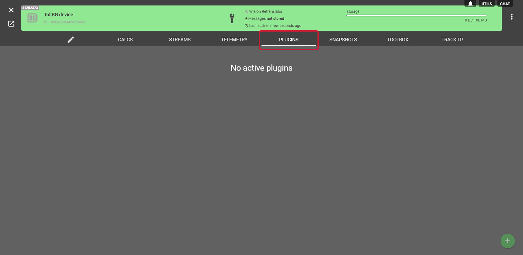

  • Go to the Plugins tab:

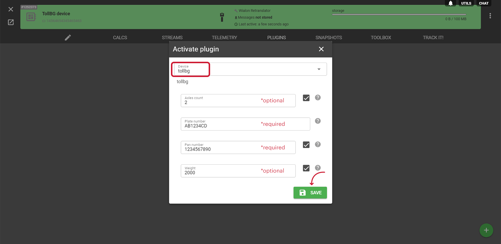

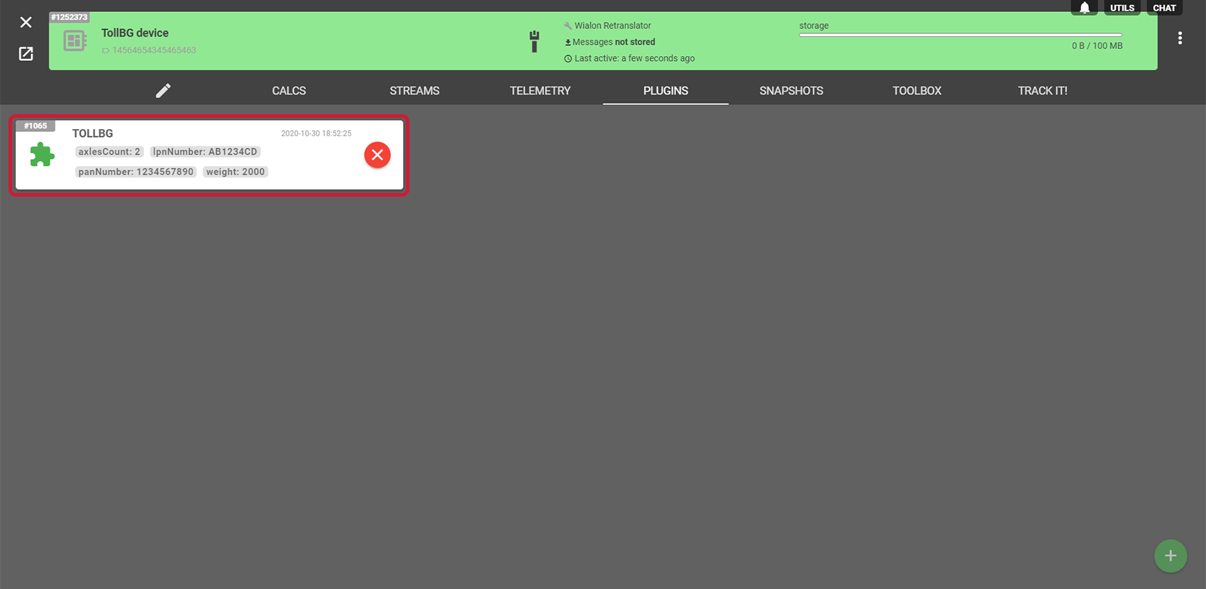

  • Сhoose the tollbg plugin, enter the Pan number and vehicle license plate number (required), vehicle axles count, and vehicle weight (optionally). Click the Save button:
Enter the data
  • The plugin is assigned to the device:
The plugin will automatically add the parameters required by the BG Toll system into the original device messages.

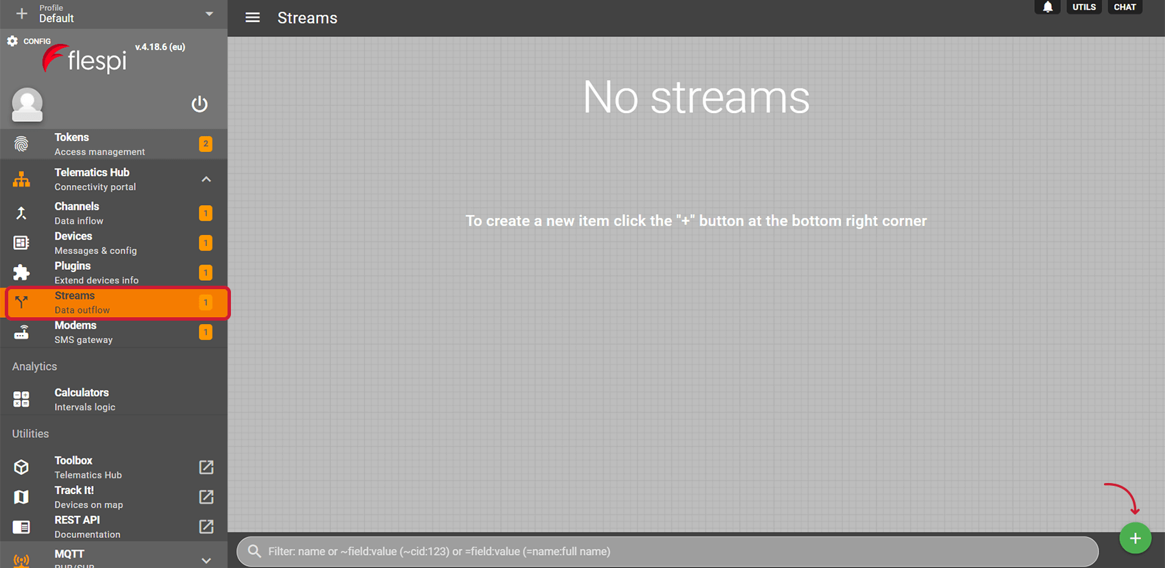

  • Go to the Streams tab and create a new one:

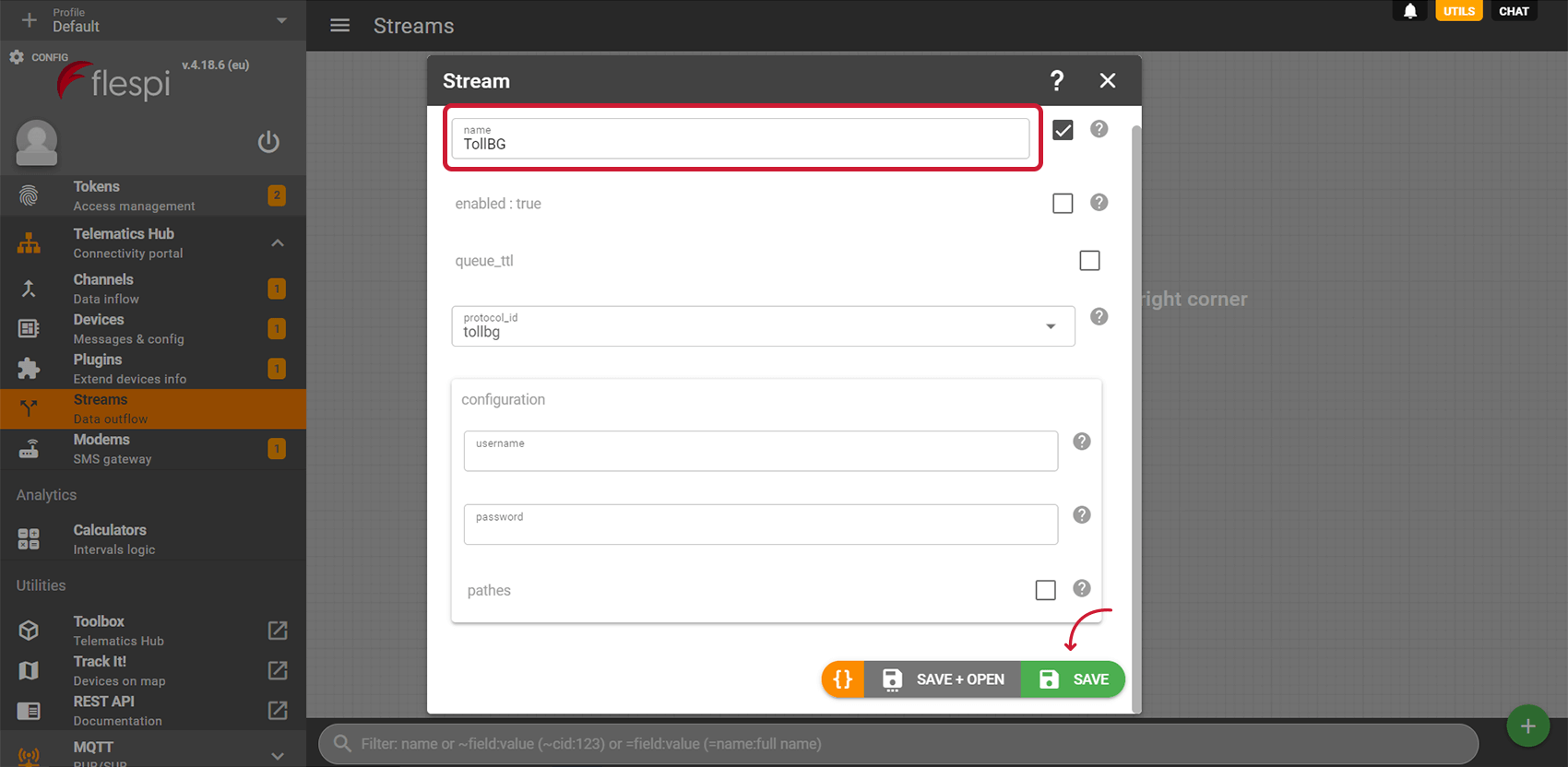

  • Use the following configuration to input your BG Toll username and password:
The configuration to input your BG Toll username and password

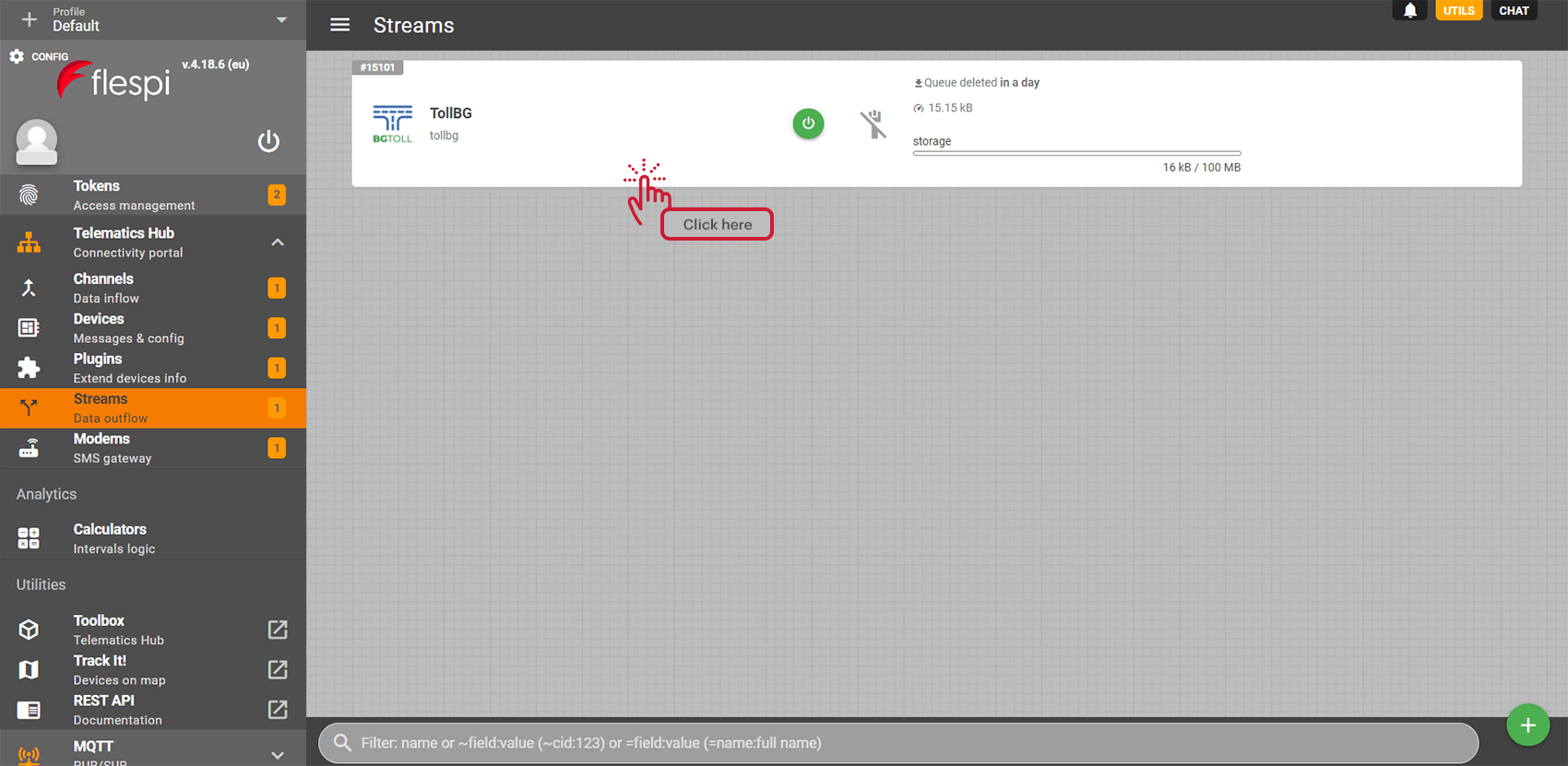

  • Open the stream card by clicking on it:

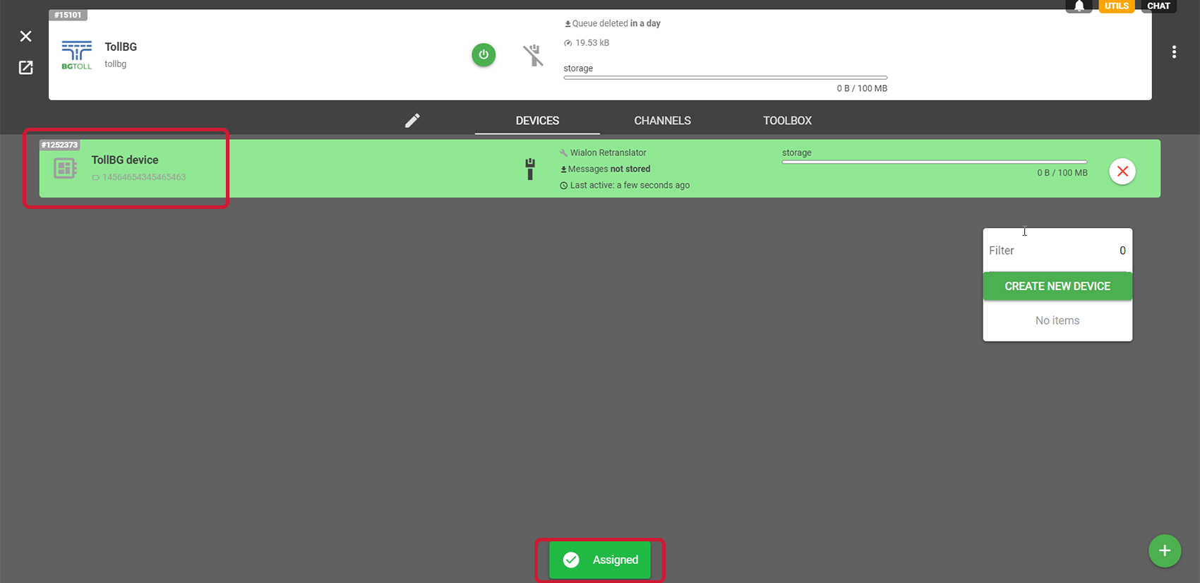

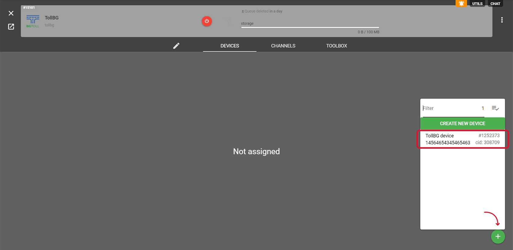

  • Navigate to the Devices tab to assign devices to the stream. This way, you indicate from which particular devices the stream should forward data:
  • The device is assigned to the stream:
Once the connection is established, the stream card turns green. New messages from the devices will be sent to the BG Toll system via the activated plugin.
