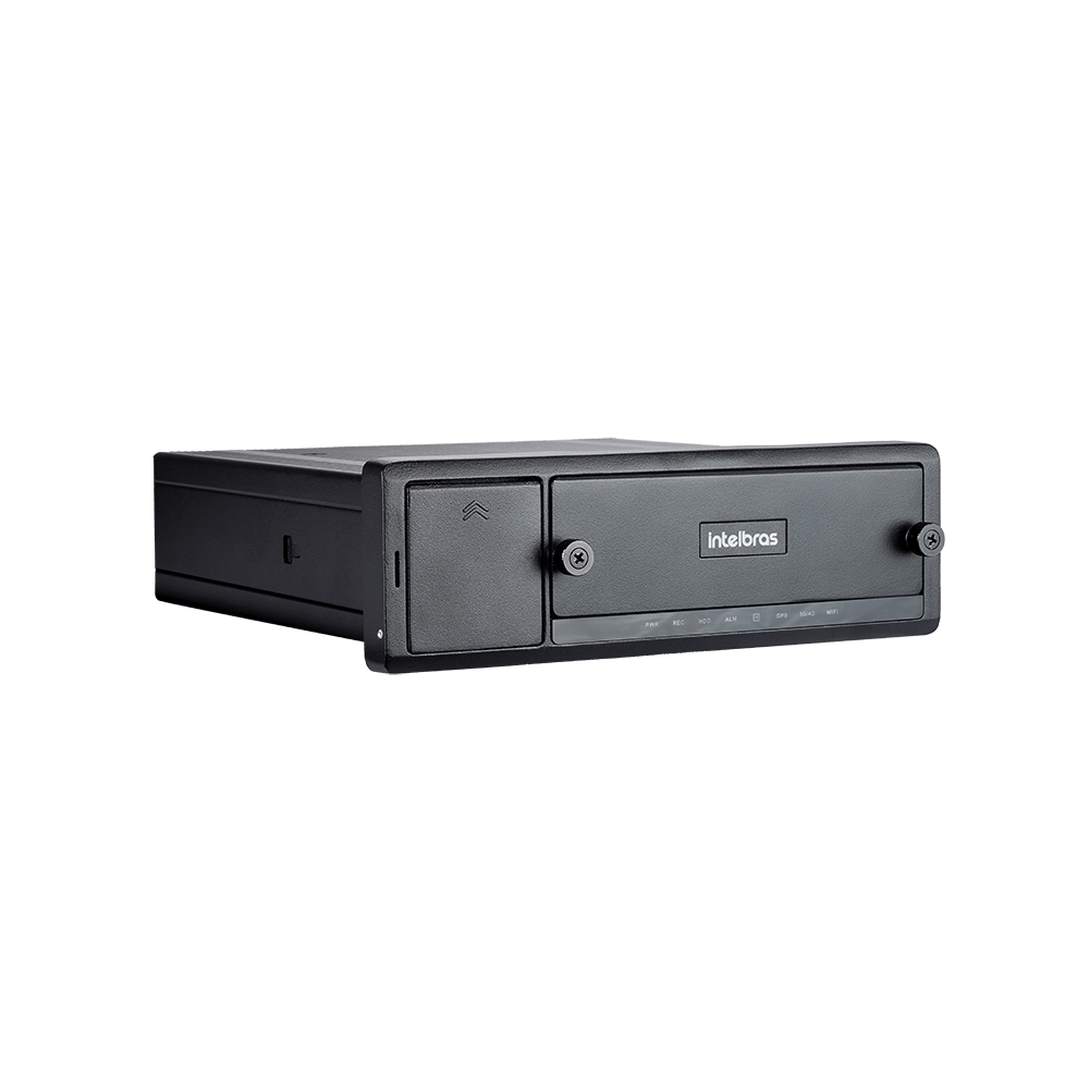

Intelbras MDVR/Dashcam
Manufacturer: Intelbras
Number of units
18
Online
138
Total
Features Intelbras MDVR/Dashcam:
  • GLONASS support
Supported in Wialon:
  • Accelerometer
  • Event video
  • Live stream
  • Playback
  • Communication via TCP
The following data should also be added to Intelbras MDVR/Dashcam unit properties section of Wialon GPS tracking software :
Device type: Intelbras MDVR/Dashcam
Unique ID: custom
Specify the following parameters in configuration software or configuration Intelbras MDVR/Dashcam for use in Wialon Hosting :
Server port: 22882
138 units of Intelbras MDVR/Dashcam device type are connected to Wialon Data Center. This represents 0.22% of all Video monitoring connected.
