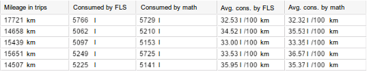

Knowing the idling rate for Scania heavy trucks, we applied this configuration to other units of the same heavy truck modification and got the following result:
Seasonal coefficient calculator
It is almost identical to the one we got with FLS. If we use this formula for other trucks rates, we can calculate consumption without fuel level and other sensors. And it is just by speed! Any number of sensors can be added while using this calculation mechanism. For instance:

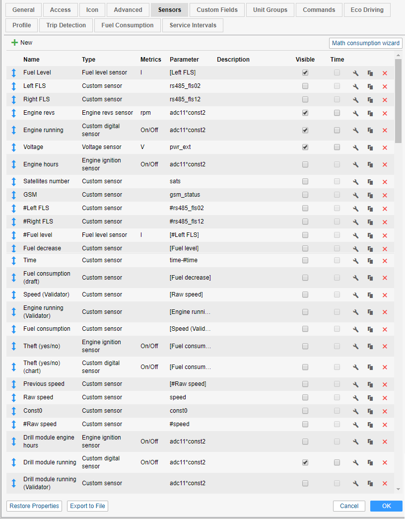

Now let’s talk about how to solve previously unmanageable issues using FLS. The client deals with oil-well drilling. His machinery appears at the needed location where it is being filled. After the work is finished, the fuel gets dumped and the machinery moves to another location. The issue was that the fuel consumption rate of such machinery was 300 liters per hour but the fuel was dumped at 150 liters per hour and at a killed engine. This fact made it impossible to display thefts that were automatically put into “Consumed by FLS” statistics section because the consumption was within the specified range regardless the engine not working. The client was not happy about it. The issue of course was solved before the update. But let’s compare the solution before and after it. As we call it, feel the difference!

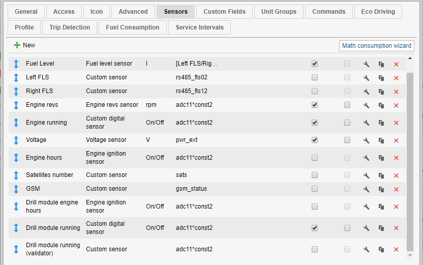

With a new fuel control algorithm we got rid of the “crutches”: we managed to eliminate several already unnecessary validator sensors (speed, engine ignition) and to create an engine efficiency sensor “Machinery engine hours” using a single consumption rate coefficient without the need to set the consumption rate for each individual sensor. Multiplying the rate by coefficient we get an on-load consumption.
On top of that, due to the option of putting the rate for the work of an engine under different load into the “Engine hours” table, it is easy to add the “Consumed by rate” column with a view to “rate*time” regardless the movement.
Previously, to do that you created:
  • the constant (const) for fuel consumption in liters per second;
  • additional FLS with data from a previous message;
  • Instant fuel consumption sensor with (time-#time)*const0.0023333333333333 parameter;
… and then made a “Consumed by instant fuel consumption sensor” column and renamed it into “Consumed by rates”, i.e. how much fuel was spent for these seconds between the messages. See how much of extra work you don’t do now?
All these allowed to considerably reduce the number of custom sensors and therefore to spend less time on configuring and to reduce the error probability.
So, having used new options we got:
  1. Accurate theft detection when the engine is killed;
  2. Set idling run rate (up to 1100 rpm) of 50 liters per hour;
  3. Set on-load fuel consumption rate (more than 1100 rpm) of 300 liters per hour.
Therefore, we are not always wrong when replacing an old handy and popular function with a new one. For the first 6 months of a new calculation method usage, it proved to be 100% efficient. And it was confirmed by both integrators and their clients.
